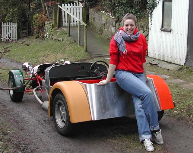

 The state of play at the moment is Chassis ahead of rear Axle complete behind it is waiting for top seatbelt mounting and rear frame and panelling. Centre is floored and panelled, front awaits panelling and also Bonnet. Cockpit to be lined.

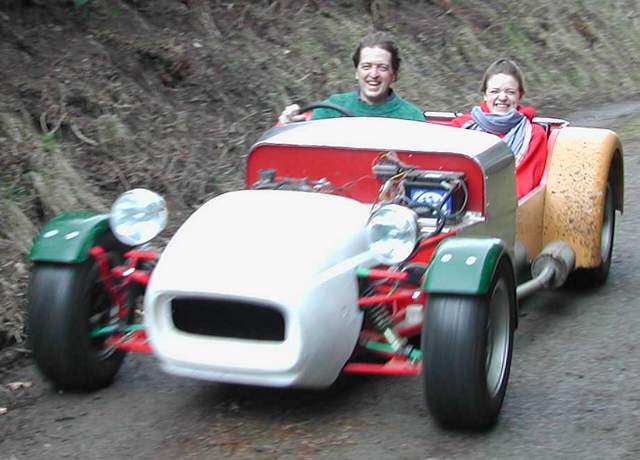

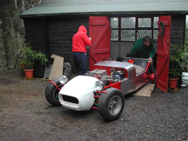

 The powertrain is in place and has run briefly, it is now sitting on RS 4 spokes and GAZ shocks and waiting attention to the rear end. However the rub is that it is being built in a shed with 4 foot doors and it is about 4 foot 6 inches wide, which leads to much hilarity from my family. Time will tell on the launch process!
 So far I have taken about three years, with weak excuses like gardening, house maintenance being fielded as required. The pictures below show the latest state of play. As you can see, running and the latest moves include a bonnet and matching colours for the plastic.
