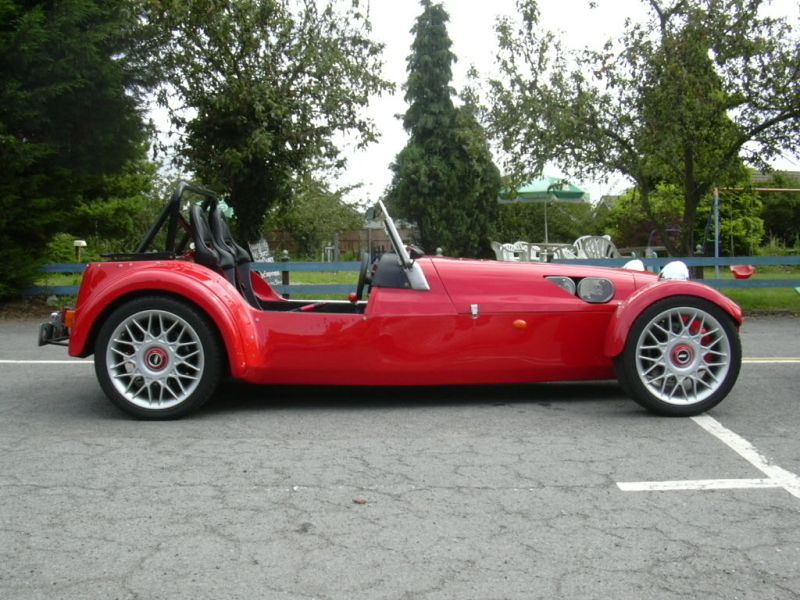

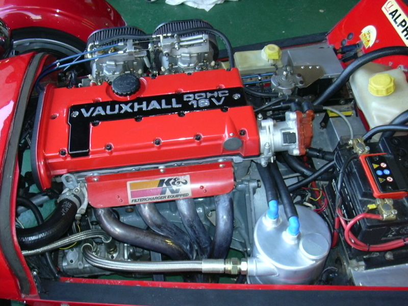

Pete's car is still in the process of being upgraded & always will be. It was built in 1992 and only took 4 months to complete. It has been registered
on a new plate, not a "Q". This car is quick, I know, I've driven it &
even though it comes out just over 650kgs, it's hard to keep the wheels from
spinning especially in the mad hands of Peter.
Hover over the thumbnails Right) to see larger images (Shows on this page) or click for full image (Opens in new window)
Spec:
Engine:

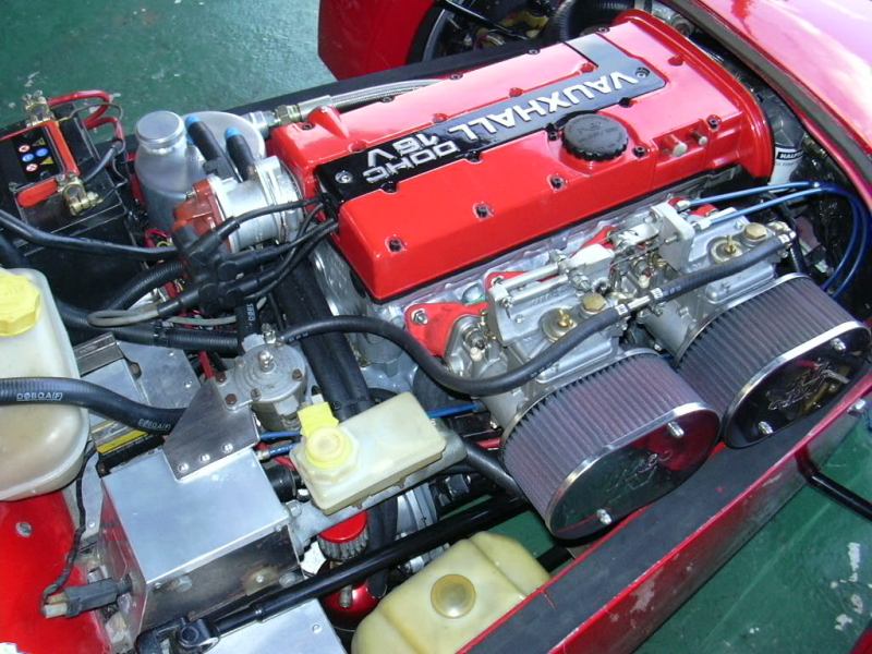

- 2 litre Vauxhall XE Twin-cam engine
- Approx 176 bhp @ the wheels
- 45mm Throttle Bodies
- K & N Filters
- ARP Rod Bolts
- QED Q42H Cams
- Vernier Pulleys
- Daihatsu Alternator and Multivee pulleys
- Westfield 4 core Radiator
- Pace Dry Sump setup
- Weber alpha 3d ignition
- Standard SEIW body with fixed rear arches. New Speedsport body (Detachable arches) spare just in case!
- RAC Rollbar and removable Petty Strut
- SPC Semi Helical close ratio box (Type 9). 2.34 First Gear
- 3.92 Diff with Quaife ATB LSD (Escort Type)
- Up-rated Driveshafts using Sierra outer shafts and Escort input shafts
- Standard Westfied with removable end for repacking
- 4-1 Manifold from Westfield

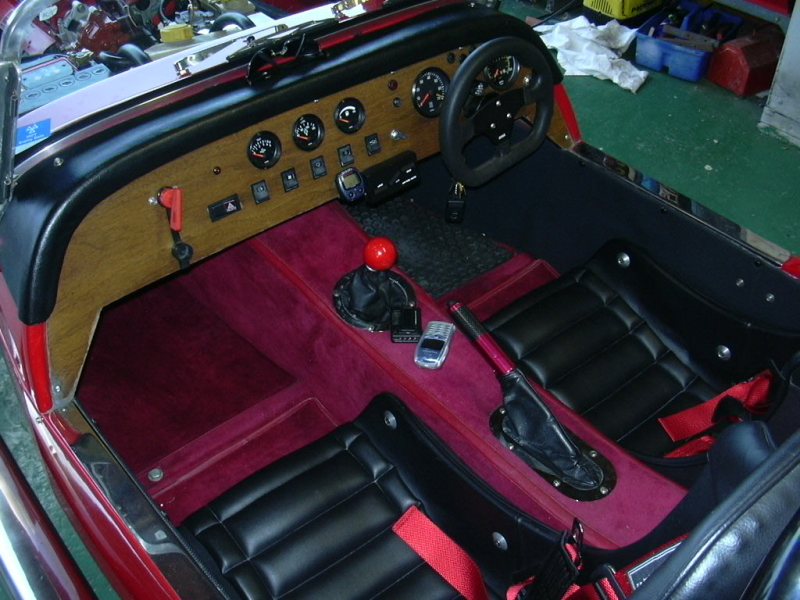

- Carbon Fibre Dashboard
- Aim MXL Pro Instruments
- Savage Switches

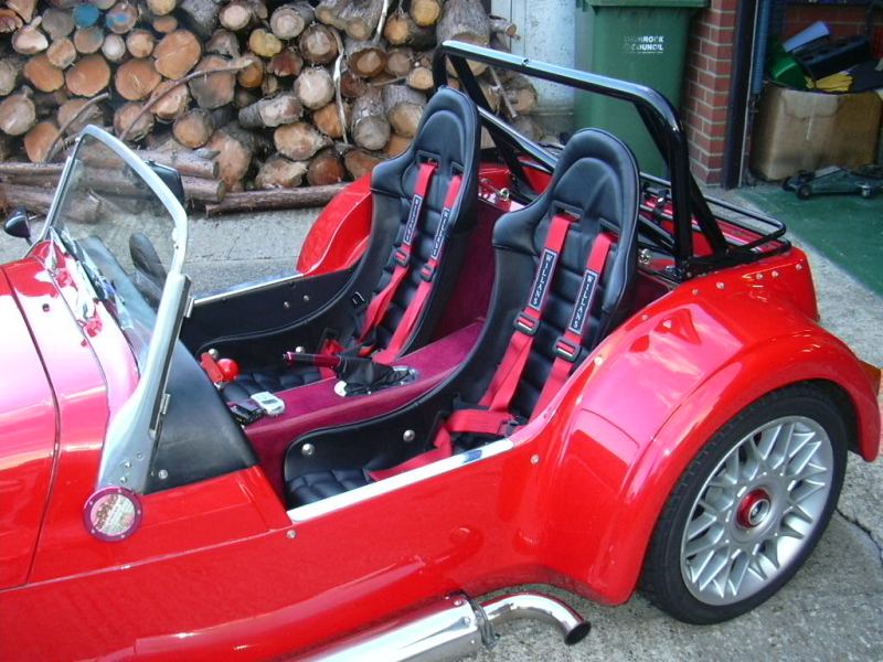

- 4 Point Willans Harness
- Westfield Race Seats
- 240mm Alpha Steering Wheel
- 4 Point Willans Harnesses
- Weber fuel ratio gauge
- A Heater
- 15" O.Z. Superleggeras
- 205/50/15 Toyo R888 Tyres
- Front Disks - Vented 285
- Rear Disks - Solid 272 Cosworth
- Front Callipers - Wilwood Billet Dynalite (1.38 pistons) 4 pots .82 rotor
- Rear Brakes - Standard Westfield with modified brackets
- Front Dampers 12" AVO 2.5 alloy pro race using 250psi 7" springs
- Rear Dampers - Standard 12" Spax 1.9 using 185 psi 9" springs
- Front hubs alloy
- GA Front Anti-roll bar
- Change Rear Dampers to alloy billet Protech units
- Maybe fit an Aeroscreen
