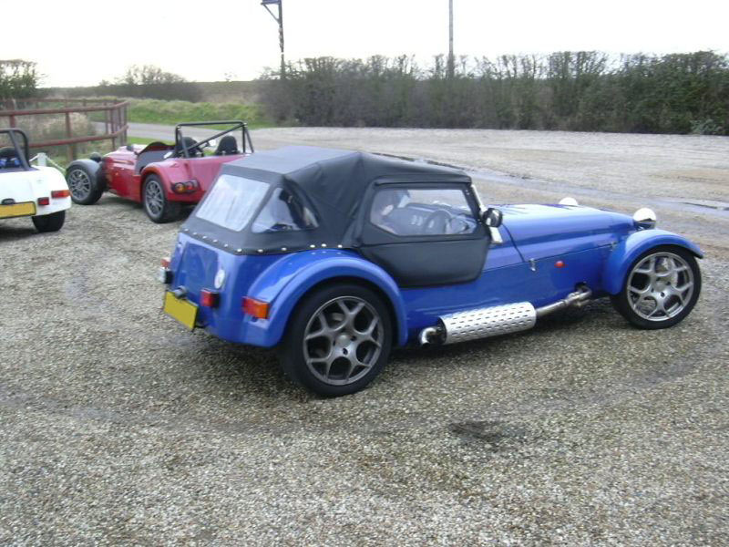

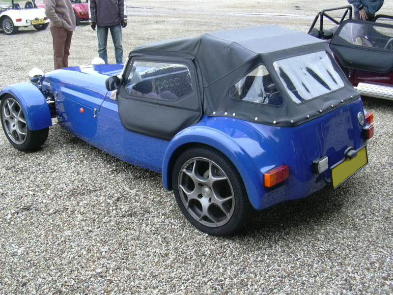

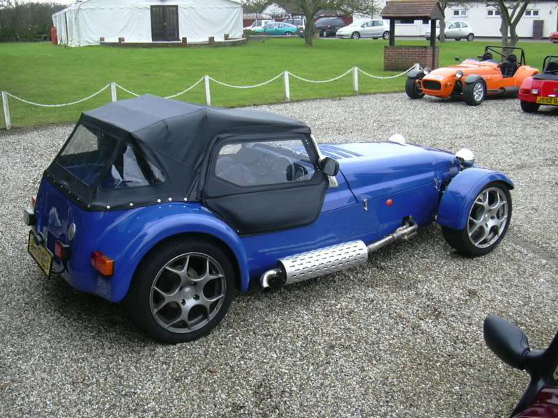

This is Matt's Car. It us used every day for travelling back and forth to work hence the roof is mostly up.
You must agree he must be brave to use it in
this weather - either that or he is MAD :-)

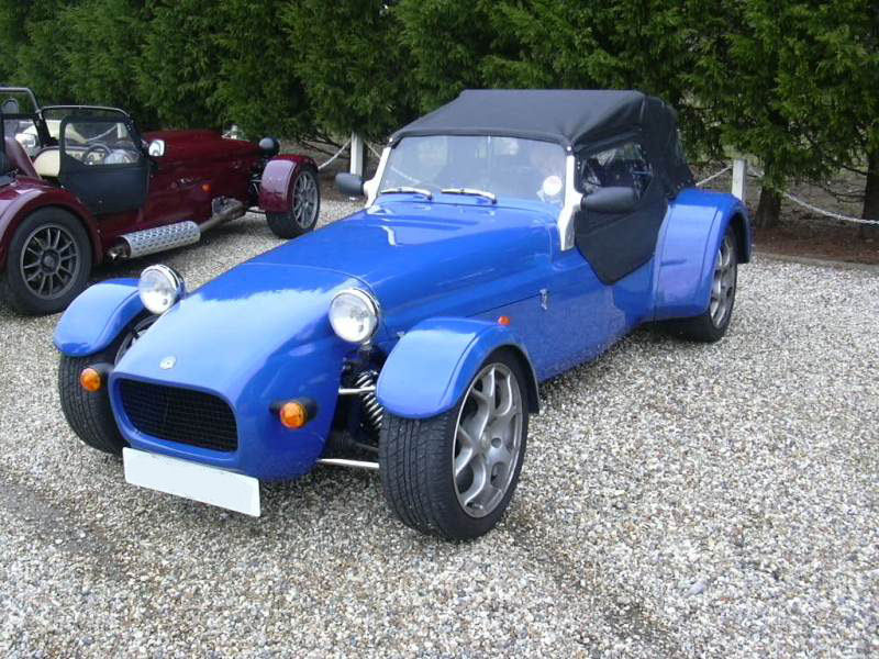

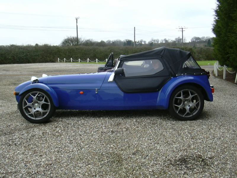

Spec:
Engine as it is now:
- 2.0 Pinto from a Sierra, with short sump.
- RL21 Kent Cam
- Polished & Ported Big Valve head
- Twin 40 Webers, short trumpets
- K&N Air Filters
- Not rolling roaded yet - Hope for 150+bhp
- Standard Westfield - modified the collector, as the joining bracket was insufficient, and welded the pipes solid.
- Spax adjustable dampers all round
- Cortina uprights
- Independent rear suspension, standard diff 3.77
- Discs all round, Red Dot grooved discs up front
- Wilwood brake bias valve
- TSW Venom's
- Tyres 205/45 R16
- Ford Type 9 with standard ratios
- Modified gear-lever
- Standard Westfield rad
- Standard Westfield fan
- Home made dash fitted with white ETB instruments
- Possibly fit a Limited Slip Diff, if I can find one!
- Adjust the ride height
This is a 2002 Westfield SEi - built by myself over a period of approx. 2 years
